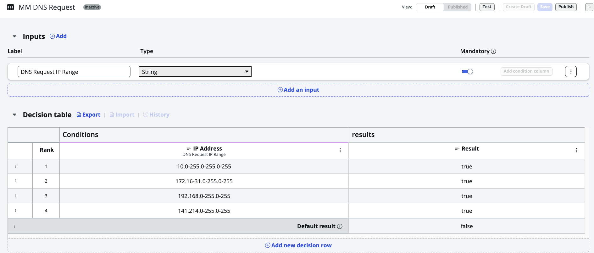

I need to write a catalog item flow that will check for three separate IP ranges on a single variable. If the IP that is entered is outside those ranges, then I need a group approval to be created.
Any ideas would be appreciated.

Hi @MonicaW ,
For basic understanding i will add the sreen grab of my PDI flow and DT.
if still facing issue you can have a look at the Document i have attached named 'Catalog item check IP ranges' it has a detailed overview of what i have done in my PDI like Flow design, Decision Table, RITM raised for IP address within the range(those 3 IP Adress) and Out of range.

Hi @MonicaW ,

I just saw the "between" option...I will try that and provide the range on each line!

Hay @MonicaW ,
There is an option, we can use is One of operator. PFA,
eg - 10.8.255.255, 182.158.1.255, 152.15.255.255 i have added range of IP's as csv in the value section.
