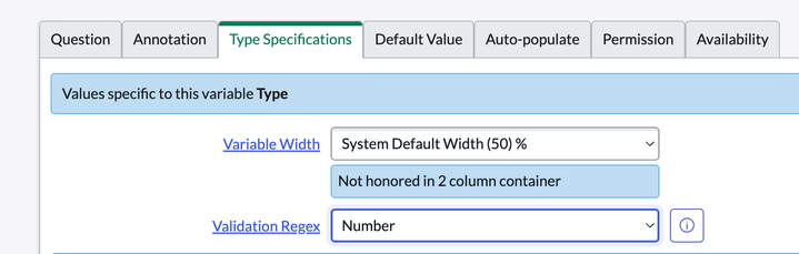

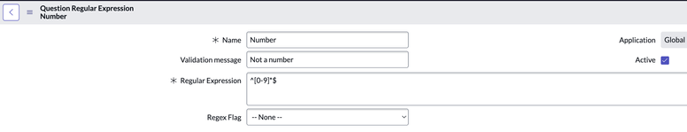

03-20-2025 05:44 AM
Use the variable type 'single line text' then on the Type Specifications tab you can select a pre-defined Validation Regex
If there is not one that fits what you are looking for, create one under Service Catalog > Variable Validation Regex in the left nav
03-20-2025 05:47 AM
No scripting required.
You can use Variable Validation Regex and attach it to your variable as shared by @Brad Bowman
