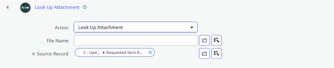

Hello, I have trouble setting up a flow that will send an email using the Send Email action that will contain the attachment(s) that the user has uploaded in the form submission process.
My flow is this:
And the look up Attachment action is a bit higher in the flow :

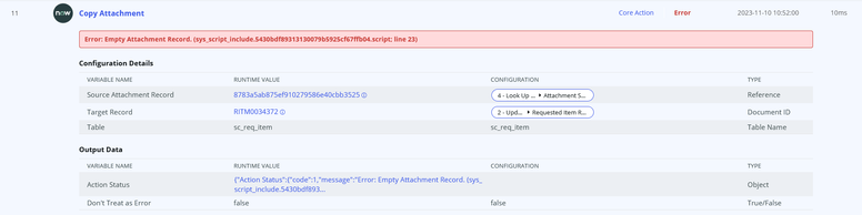

When I try the flow I receive this error:
Can someone give me any hints on this?

Hello and thank you all for the replies! After a bit of fiddling I found the issue and corrected the flow!
Thank you all for looking into my issue!

When you run the flow which record is fetched by 4th Step (Look up attachment)?
Are you getting expected attachment?
