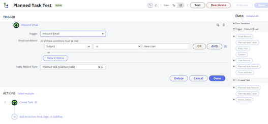

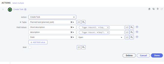

I am experiencing an issue with a flow. The flow is configured to trigger when an inbound email has the subject "New User". It should create a planned task using the details from the email. The flow is currently active. Although I have sent multiple emails to SN with the subject New User, it hasn't created any planned tasks. I'm unsure what else to verify. Any suggestions?
These are the screenshots of my flow
