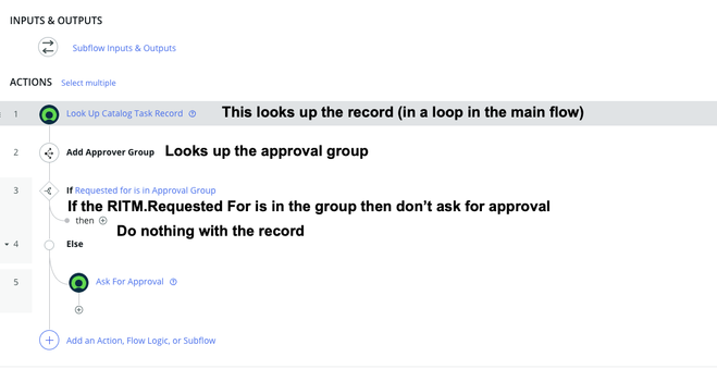

Ok, I'm going to try to explain this as best I can.
I have a flow doing approvals for SCTASKS. I have a subflow that will loop through the SCTASKS and look up information as to whom the approver is. New requirement is that if the Requested for in the RITM is in the Approval group then don't ask for approval.
So with that said.
I'm using a decision table to get the approval group. Then I'm using that to update the ticket with the approval group so send the group notifications that they have approvals to do. I need to know how to take the decision group that I get and see if the Requested for person is in the Approval group.
Does anyone know how I can do this?

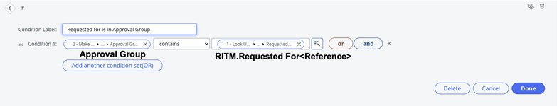

Here is a picture and text of what I'm trying to do. I don't see anywhere to say if the group contains on the if statement
The second picture is the if statement
