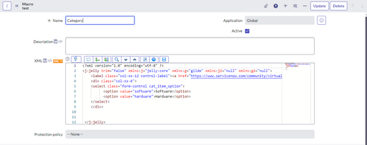

1) Navigate to All > System UI > UI macros > new .
2) All following code in the UI macros (just an example. modify code as per your requirement).
<label class="col-xs-12 control-label"><a href="https://www.servicenow.com/community/virtual-agent-forum/how-to-add-a-hyperlink-to-a-select-box-variable-name/td-p/2968405">Category</a></label>
<div class="col-xs-6">
<select class="form-control cat_item_option">
<option value="software">Software</option>
<option value="hardware">Hardware</option>
</select>
</div>
</j:jelly>

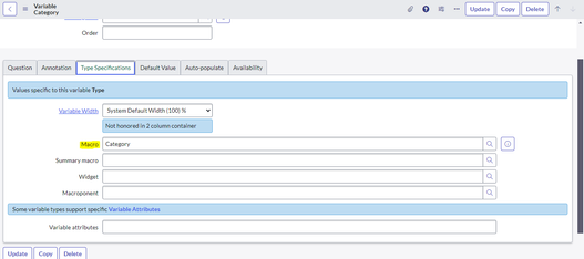

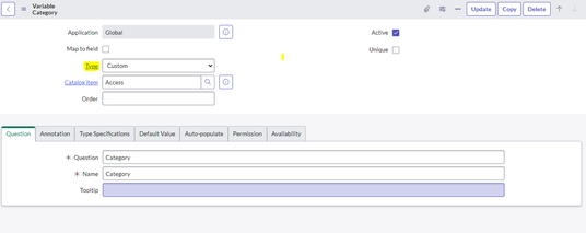

3) Create variable. Choose type Custom.
4) In Type Specification tab, in macro field choose created macro.
It's looks like this in the form:
