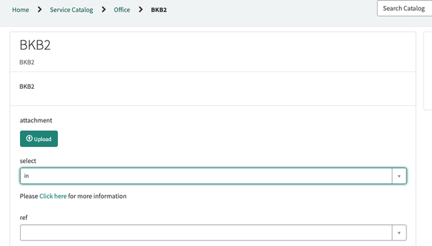

in the above image it's working in native.
Are you checking in portal? Possibly it won't work there due to DOM manipulation.
12-07-2023 11:43 AM
Needing to use this in Service Portal would have been excellent information to have at the outset - along with needing it conditionally, and on a Catalog Item variable as opposed to a table field,.........
One alternative that works in both interfaces is to create a variable with the type Rich Text Label (which should sound like a familiar suggestion), then use a simple, administration beginner's-level Catalog UI Policy to hide it unless another variable's value is whatever your requirement is
12-08-2023 12:40 AM
Thank you so much I have used rich text variable.
