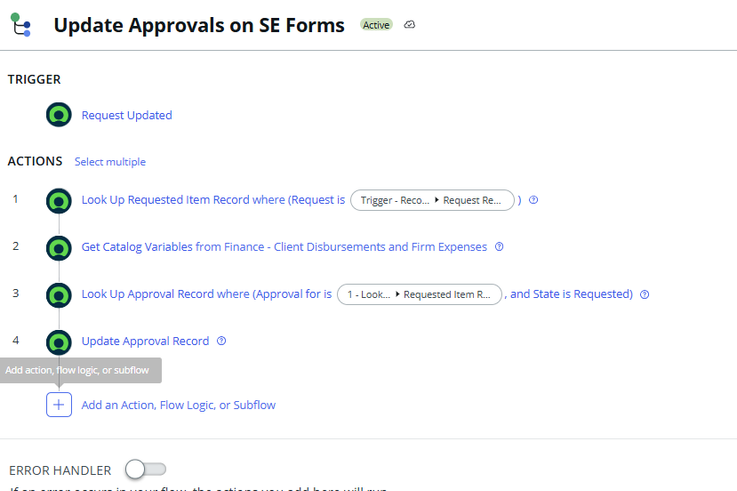

I was able to create a Flow to update the Approver however b/c its triggered from the sc_request update it will not run unless i add in the req# for the test
how can i detect when the user updates the ritm onto the req
