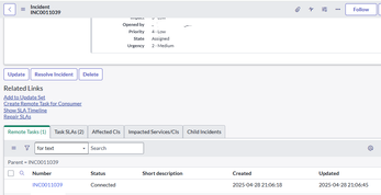

Now i can see i am sending the assignment group name, here the incident is connected between provider & consumer instance with Remote task, Like when i can create an incident in the provider instance , it will generate a remote task and the same remote task will be connected to consumer instance and that will create the incident in the consumer instance.
Here when i create incident in provider and sending it to consumer, the incident is created, but the assignment is showing up in the remote task but not on the incident.
This is the incident i have created in my provider instance
The same connected to consumer. this is consumer remote task , here in the remote task Group is shown, which i have sent from the provider.
but on incident the group is not showing up (consumer incident)
