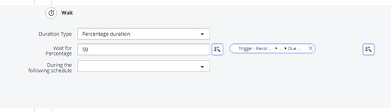

Can anyone explain how to trigger notification, when problem task elapsed 50% duration (Due Date – Assignment Date)/2? Can we do it with Scheduled job?
Mark Manders
Create a new flow to trigger on the assignment date (you have the start) then. Add a wait condition to wait for a percentage duration on the due date and then the 'send notification' action to complete everything.
No need to script with all kinds of calculations you need to do.
Or, if you have SLA's running on the Problem tasks, you could utilize the OOB SLA workflow with its notifications on certain percentages.
