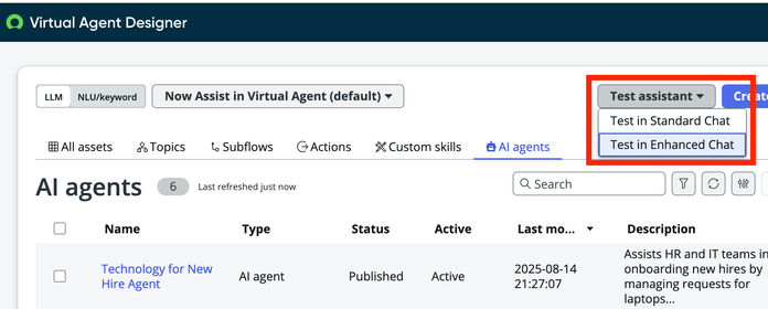

warren_chan
To troubleshoot, you can also open Conversational Interfaces > Virtual Agent > Designer, select your Conversation Assistant, and there should be a button to "Test assistant". Here, you can enter and try various utterances to see if they invoke your AI Agent.
