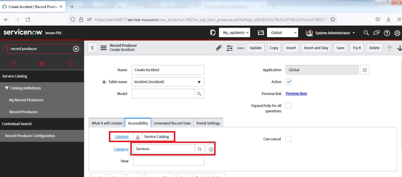

Follow the steps it's tested
Change catalog and category in which you want to display record producer.
Map the field in Variable and select the fields which will from incident table.
