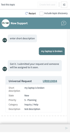

InOrder to make the OOB create incident work, you need to input the data requested and call that topic block inside another topic. If you have directly tested topic block it won't work.
1. create user prompts for short description, description, urgency and cmdb_ci.
2. call topic block - create incident using utilities
3. map the variables to each of them like below
Output
I have universal request enabled so it is generating universal req, but if don't have universal request, it will be directed to incident creation.
