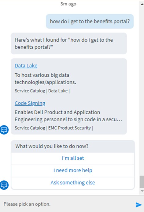

In our San Diego instance, the Custom Greetings and Setup section contains a specific HR Fallback setup topic as the official set up topic for our VA. However, when user types a phrase that VA does not understand, instead of triggering the HR Fallback topic configured in Custom Greetings and Setup, VA runs the OOB Run AI Search and AI Search Fallback setup topic.
We are unable to inactivate Run AI Search and AI Search Fallback setup topics because they are OOB.
How can we disable these 2 so that the fallback topics that is configured under Custom Greetings and Setup is the only one fallback topic running?
