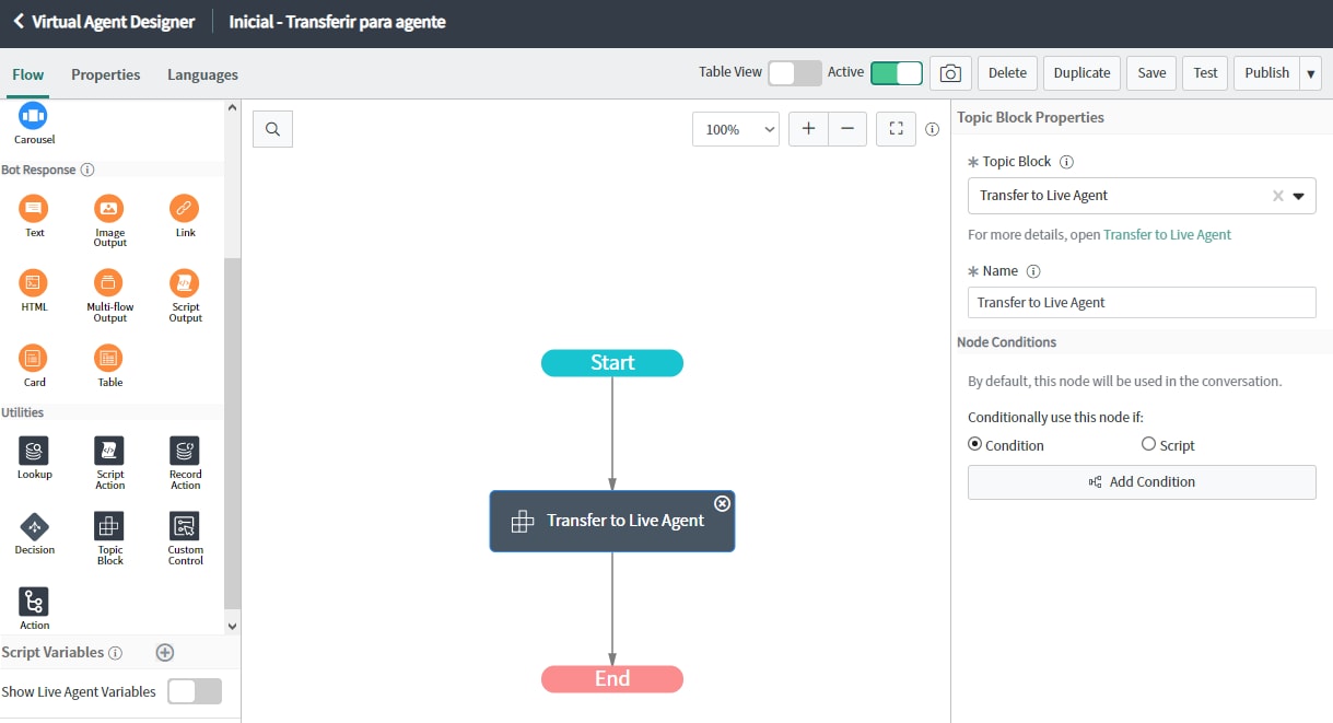

Hi Declan,
Create your own Setup Topic like this:
Then go to:
Custom Greetings and Setups -> Default chat experience
In the Greeting type topic, link the Setup Topic that you created

Hi Declan,
Then go to:

Hi there,
Sure this is possible by creating a new setup topic which transfers to a live agent, and set that topic as greetings topic. Caution though: do you really want to do this? This could lead to a lot of pending chats at your Service Desk or whoever is going to handle this. This will also create expectations, can you actually make those?
I wouldn't go this road.
