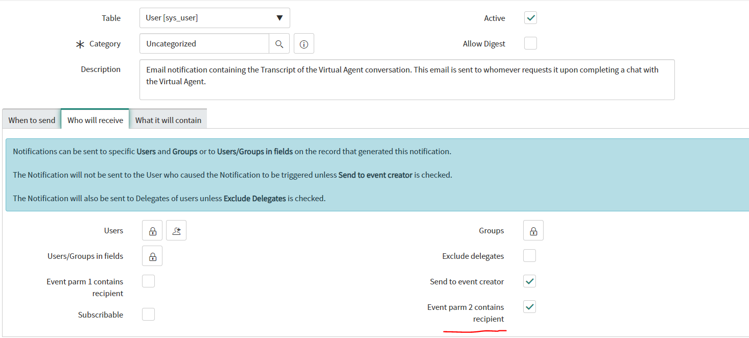

Hi both,
Firstly thanks for such a thorough guide, I was able to get the functionality up an running but am having an issue when it comes to the notification. At current the event fires however the e-mail is not sent to the user that completed the VA chat. I thought by having "Send to event creator" checked in the 'Who will receive' tab of the notification would be enough, however this doesn't seem to work.
I have tried manually putting my e-mail address in the 'who will receive' tab and it worked fine, so I know the event/notifications are working. Can either of you help advise on how you are getting the notification to send to the user that has asked to receive a copy of the transcript via VA? I could store it in Parm2 but ideally I want to use this for getting the user's first name so I can address the notification "Hi ${event.parm2}," so it's personalized to the user.
Richard
Hey there!
Glad that this post helped you out! So I, like you, wanted to personalize our email notification as well! What I ended up doing is have the Event Param 2 holding the recipient, but having the notification itself utilize the User table (sys_user). This allows me to fetch the user, who is the recipient, and their subsequent information. I'll share some screenshots to clarify:
Please note in the Message HTML that we changed the transcript to be fetched in a separate mail script because we are populating this email with additional things as well. For purely just the transcript you can still keep it as it is (Event Param 1). Let me know if this helps!
