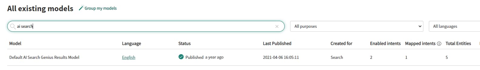

Hi @Sandeep Dutta
Thanks for your reply.
I have read the documents you sent me and checked my instance.
On my side "Default AI Search model" is trained and published:
I try to use a very similar statement in the model as a query:
But it still returns me regular search result:
Do you know what should I do next?
