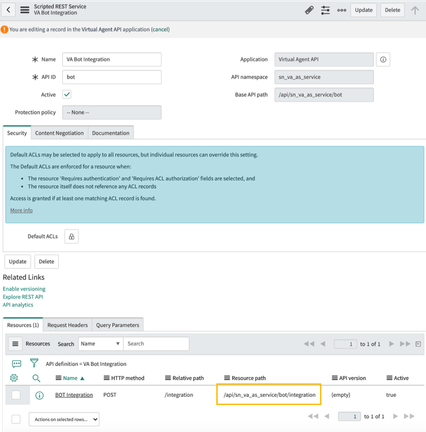

I want to integrate the Microsoft bot with ServiceNow Virtual agent in which I will consume ServiceNow VA as a secondary bot. Using Virtual Agent API I am able to send Inbound requests to ServiceNow VA and also got responses from ServiceNow VA to configured outbound third-party endpoint.
I've been using the following API to send requests to ServiceNow VA.
Currently, the responses getting from ServiceNow Virtual Agent on an outbound third-party endpoint but how can we get these responses in my MS Bot?

You can't send the VA API response directly to the MS bot as MS Bot might not be able to understand the VA API response payload. You will need a transformation layer in between.
I have created one script include in which I have replicated the "VABotToBotRestMessageHandler" with minor changes.
I have called this script in my bot integration scripted rest API. So, when I call my Inbound bot integration API using postman, I can see the response of the virtual agent in postman.
And I am parsing the response got from ServiceNow virtual agent explicitly in MS bot composer to send it to the user.
So, is this the correct way to get a response from ServiceNow VA and to use ServiceNow VA as a secondary bot?

@surajmusmade18 Your approach looks fine.
I'm curious to know why you had to replicate the VABotToBotRestMessageHandler script.
I don't see any synchronous checkbox in my Bot-to-Bot channel record.
Try updating the form layout of sys_cs_channel table.
