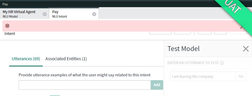

02-02-2021 06:29 AM
We continue to see this pink ribbon with no error message when testing the nlu model intents. Initially, I am able to test a few utterances, but after just a few, this error pops up. Today it happened in UAT, but it's been happening in other subprod environments. Any help on what could be causing it is greatly appreciated.
