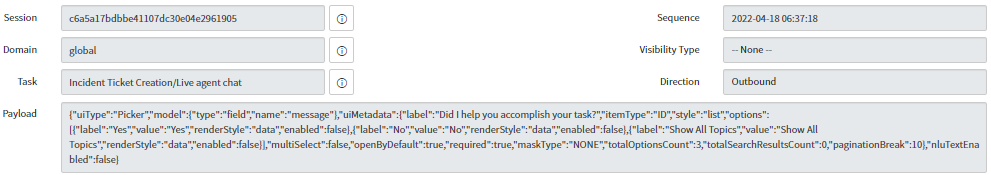

05-16-2022 10:25 AM
For each message from VA and the response from user, separate entries will be created in the table.
The one which you shared here is the message from VA. There will be another entry from the same conversation which has the response from the user. Please refer the screenshots below.
The first screenshot is the entry for message sent by VA and the second one is the response to it. You can confirm that by looking at the Session ID and Direction in this screenshot. We are just filtering the inbound entry with our user input title. Since I was not able to work on the function field with the direction filter, I have used ENDS with Yes or No.
The example which you have pasted here is an outbound entry which we need not consider.
Hope this clarifies!
