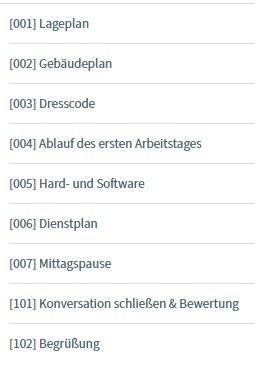

Hello everyone,
whenever I click the 'show me everything' button in the virtual agent chat, it shows all topics and also some, but not all, setup topics.
I don't understand why it shows setup topics at all, they should not be presented in 'show my everything', right? Since they are setup topics, they should not be recognized through NLU at all.
The type of '[102] Begrüßung' is set to 'Setup Topic' but it is still showing in 'show me everything' this should not be the case, right? Is there any way to hide this setup topic from 'show me everything'?
Other setup topics are not being shown, that's why I don't get why this one is shown.
Thanks in advance

07-29-2021 06:35 AM
I fixed it. First you have to search for 'custom greetings and setup' and then click 'default chat experience'.
Then click on the setup topic that you want to hide. I highlighted it in yellow.
And then make sure that 'is system topic' is checked and then hit 'update'.
