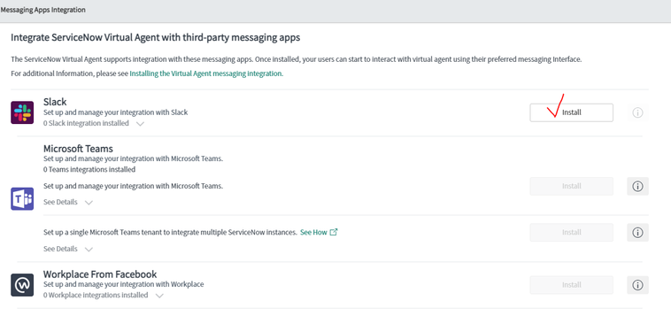

I've try to connect to Slack via Virtual Agent Setting but It isn't redirecting to Slack Auth
Screenshot of steps below
1. Click [Install]

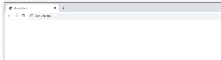

3. Popup window shows about:blank
Is anybody faces same situcation? How can I resolve this?

Hi, I am having the same problem as above. I also confirmed I am not currently logged into any Slack Workspaces and there are no pop-up blockers.
I am running Tokyo Patch 4a
Version 4.1.0 for the "Conversational Integration with Slack" plugin
In the Log table, I see Error "Can't find External App Information: no thrown error" and "Exception Got while fetching the information from proxy DC Instance: no thrown error"
