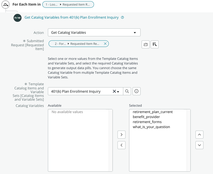

Have you tried using the get catalog variables action. If the requested items are based on the same item this could be a good option
This will add variable data pills that you can use in your flow

Hi Shane,
I tried that but I wasn't putting the Get Catalog Variables in the for each loop so it wasn't working. Once I moved it in the for each loop as in your image, it worked like a charm! Thank you so much for your help, I really appreciate it!
