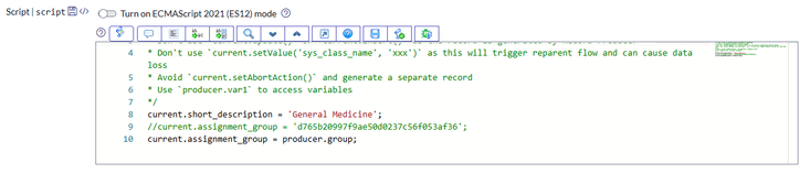

@Ankur Bawiskar
The first screenshot shows the two fields that I can use, preferably fulfillment group. Using SN Utils you can see the Values of the fields.

In this Screenshot you can see the record producer script field with the script that is currently not working. What I can get to work is also visible in this screenshot but made into a comment using //. This is a non-dynamic fix which is not optimal.

In the last screenshot you can see the case record after I submitted the form.
Please let me know if you have any more questions.
