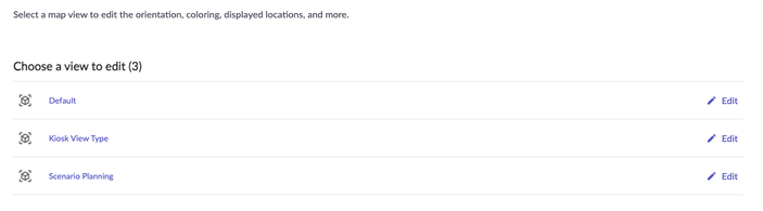

Hello @jp_rayudu_0909 , can you please confirm that the "Scenario Planning" view is active for the buildings and floors?
You can manage the views by opening Map Studio > go to "view editor" > select "Scenario Planning" and edit the view from here.
