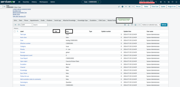

07-30-2026 12:07 AM
did you check for any config, ui policy or client policy blocking the same field to set ??
check in audit history if the field value is being changed..
