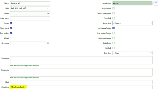

Hi @Utsav JAISWAL ,
You can create a UI action and select the 'list banner button' checkbox, if you want this button to be visible only in related lists, then you need to add this condition in the UI action.
RP.isRelatedList()
If it is a many to many related list then you can use RP.isManyToMany() along with the above condition and if it is one to many, you can use RP.isOneToMany()

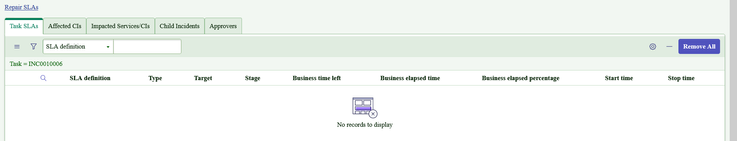

Ex. I created a UI action 'Remove All' on the 'task_sla' table with this condition
Related List of incident:
Task SLA table list view:
