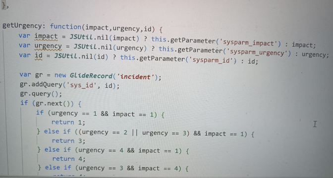

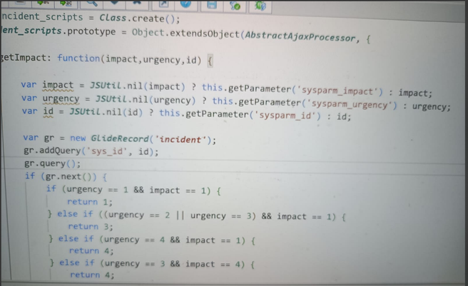

04-24-2025 06:38 AM
Hello Ankur,
It is not working in BR.
I submitted a record producer which creates Incident. So, while submitting I have given Impact as 1 and Urgency as 1, so the Priority has to be set as 1 but it set as 4, (so not working).
Please help me in correct my code:
My Script Include:
My Business RUle:
Lucky
