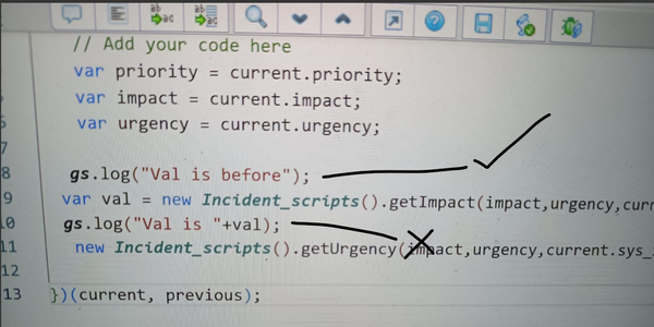

Hello Ankur,
The first log is coming up but the second log is not coming
Lucky
@Lucky1
In that case it means you are unable to call it
I will suggest you to check the script include is in which scope and check by adding logs in the script include function
There are numerous blogs and articles on how to effectively debug your scripts.
