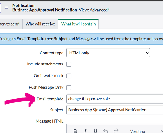

Yes, I see the Approval Request notification, and the Email template it is using in What it will contain section.
Actually, I have used the same Email template in my custom notification but i cannot see it in the Email logs.

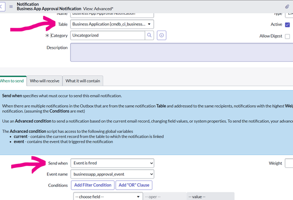

My custom notification:--
And I am triggering event from Flow Designer (I guess here there is something wrong)
In the Look up record action, I am using Business application table and condition is sys_id is inputs -->CI
Note: In the Event log, I see that my event is processed but no email triggered in the Email logs.

you are using "Ask for Approval" so it will insert record into sysapproval_approver table.
But your notification is on Business App table -> this is wrong.
You should have notification on sysapproval_approver table and use the same template.
