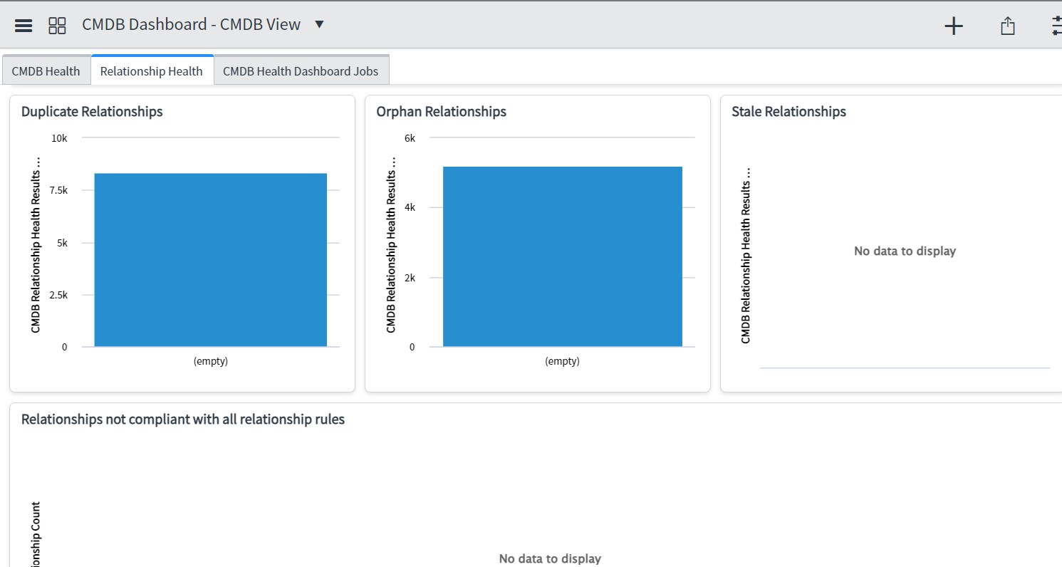

I need your help: The CMDB Dashboard is currently not displaying any data. I have enabled all the "CMDB Health Dashboard Jobs" and also executed them. I see this:

Hi Murali,
After my investigation, I have found that the status is missing (Metric).
Do you know how to restore (CMDB Health Metrics). I have already tried importing xml of those records but I am getting permission denied error.
