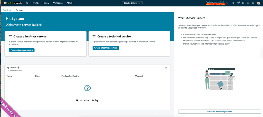

Hi @amitmanna
First create the Service, and then add the Service Offering.
When creating the Service, you can select the type — Technical, Business, or Application.
You can create the Service Offering using Service Builder:
Steps
Go to Service Builder.
If a Service already exists, select it — otherwise create a new one.

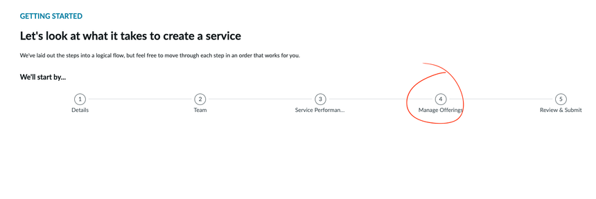

Continue through the steps.
At Step 4, you’ll see the option to create the Service Offering.
