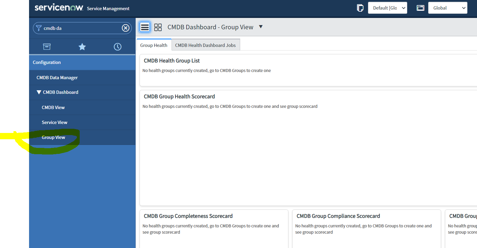

If You want separate classless, use cmdb group dashboard
here you can add your own custom classes or group of classes.Also when you click on the score in the score card of any cmdb dashboard, it will redirect to new dashboard score individually for that score card. completeness, complaince, correctness separately on click on scorecards
