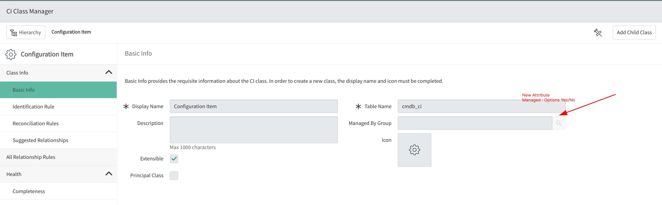

Is there any way to add the new custom field on the CI Class Manager view (check the below screenshot)?

Hi @Parth15 ,
Yes you can add. Go to CI class manager.
go to Attributes. (you must have enough previlage to add new field . eg. admin or cmdb_admin role)
go to 3rd tab > added. here you can add a new field with field type. (this field will be visible only to the current class.)
i hope this helps...
