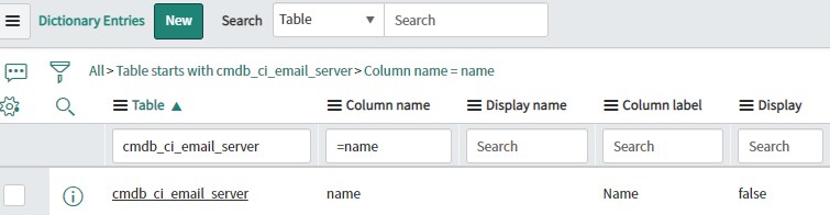

The way this works is those Names cannot be changed from Dependency View. Dependency view just pulls it from respective Tables.
For example in your above screenshot, there are few Email Server say for example:"IronMail-SD-01" . This value gets pulled from the Table "Email Server (cmdb_ci_email_server)". So in order to change the Name you need to change it in the Name field of this Table as below:
Yes, you are correct the Table does not have a Display Value as true but when there is no Display Value as True it by default takes up the Name field of the Table.
