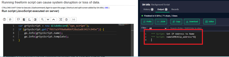

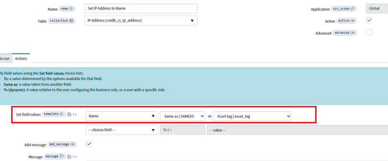

I have checked BR [Set IP Address to Name] (f657a3ff0a0a0b6f28a2ad63417c945e) and i see that the [Set field values] is nameSAMEASasset_tag. However, when i run background script, the value of [Set field values] is nameSAMEASip_address. There may be a display issue in the [Set field values], but i believe that it was the source which set the value of name.

I knew it! :), I looked at the  rule carefully but never tried .template method to verify it. Thank you very much for confirming that.
That's the answer. Thank you again. 👍
