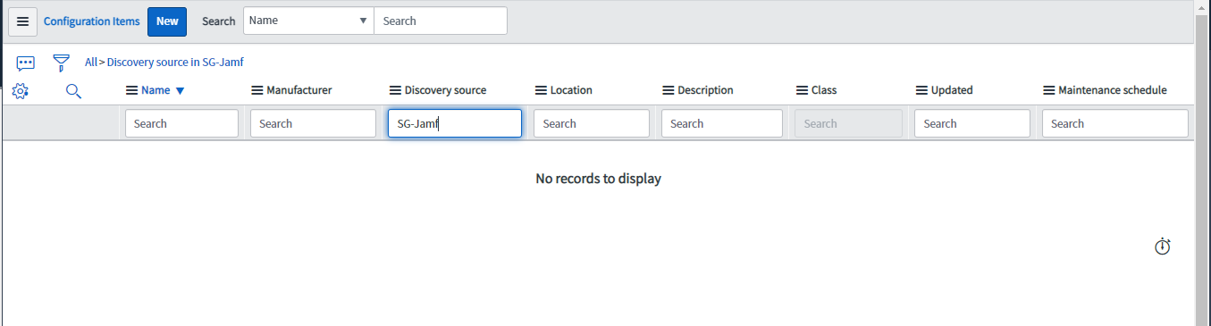

I tried to use the transform map and have the information populate in the "Computer" (cmdb_ci_computer) table. When I check the table I am not finding anything that was imported by Jamf. Here is the transform map.
Can anyone point me in the direction of what I should be doing or where I have this configured incorrectly? Also is a Mid Server required for this seeing Jamf is SaaS based? If so where would I deploy the mid server?

wildturkey07
Thats the issue. It doesnt seem to be creating records in the CMDB. Any ideas? I appreciate your help with this.
