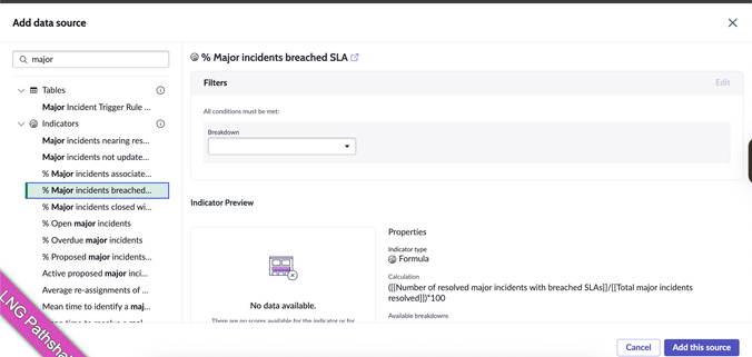

‎06-29-2025 02:50 PM
This requires some calculation, and it's not straightforward. I tried something in the PDI and found that percentage indicators are available on the MI report.
You can refer to those indicators and build your own custom indicator based on them.
‎06-29-2025 09:29 PM
Hello @Dr Atul - LNG
Thanks for response, I don't have PA subscription.
Is it possible via Databox to capture percentage of total Critical/Major Incidents out of total created incidents?
If yes, how it is, pls guide.
