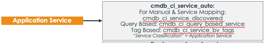

Absoulately, keeping it scalable towards upcoming releases of SNOW has much better leverage. In addition, following hiearchiey pic would hint you on the aspect of CSDM alignment.
Darin, Alec, feel free to correct.
Perfect Picture example!
To add more context to the diagram above with technical names of the table. So it is easier to follow which technical table should be used for an application service identified in a specific manner.
