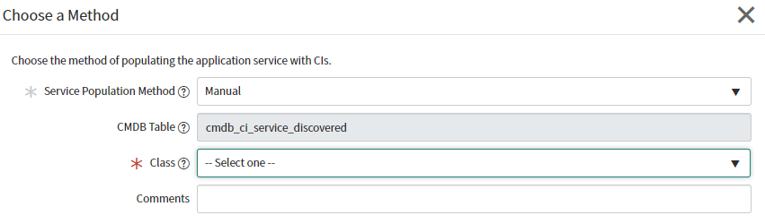

- I can create the Application Service, relate my Application Service to my Business Application, and on "2. Populate the Application Service" if I choose "Manual" I am required to select a specific CI from the CMDB
If I specify a Class and pick a specific CI, I can then see that my Application Service is created. I also see that I can find the Application Service record on the CMDB_CI_SERVICE_DISCOVERED and the CMDB_CI_SERVICE_AUTO tables.

- If we are manually populating our Application Service, and we set the Population Method to "Manual" (so that we can get the Application Service to the CMDB_CI_SERVICE_DISCOVERED table) why do we have to specify a specific CI *on creation* when we select Manual method? Why can't we do that later? It seems like this assumes I will have infrastructure created BEFORE I have my Application Service created. But that's not the case in our environment. When requesting infrastructure our teams must specify the application environment (Application Service) it's for.

3 - I think you can do this later as the population method is not required you can do this at a later moment.

- Continuing: So say we have Application Services with no population method, and then our analysts begin relating infrastructure to the Application Services manually (or via a catalog item process). Would it be recommended to set a population method of 'Manual' on the Application Service at that point?
The reason I ask is that I've noticed that once I set the Population Method on an Application Service to Manual, that from that point forward if I attempt to open the service Record (whether from CMDB_CI_SERVICE_AUTO or from CMDB_CI_SERVICE_DISCOVERED) it opens the form view of the record on CMDB_CI_SERVICE_DISCOVERED. My issue with that is that a base user with ITIL in my PDI is able to edit fields on records on CMDB_CI_SERVICE_AUTO, but base ITIL user is NOT able to edit any fields on records on CMDB_CI_SERVICE_DISCOVERED.
My only concern is that we start mapping our infrastructure to Application Services manually, so we set the population record to manual on those Application Services, and then they all become locked to our ITIL users. Does that make sense?

2 - Would it be recommended to set a population method of 'Manual' on the Application Service at that point? Yes
