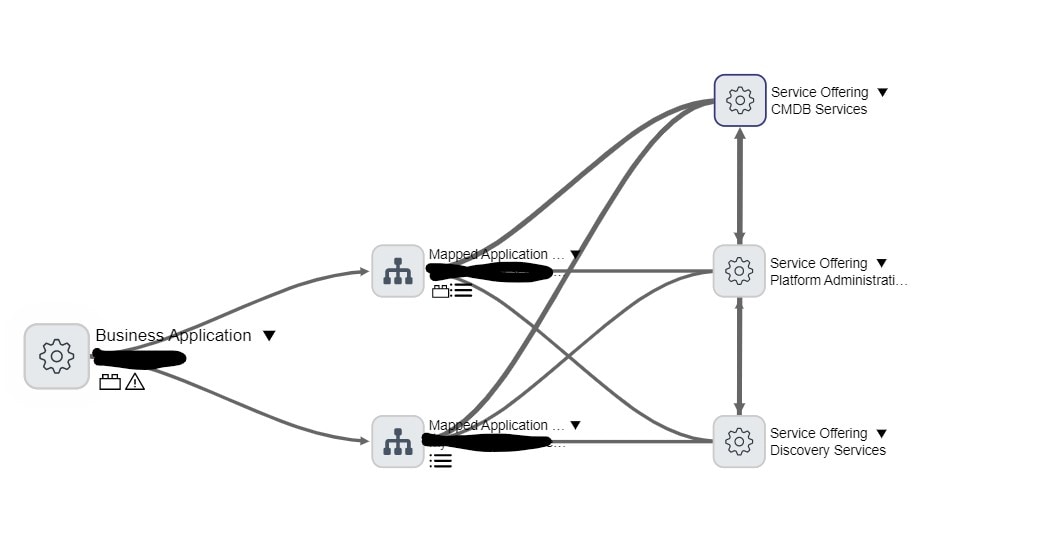

I am working on inputting and relating all of services, including application, technical, and technical service offerings. While I am able to input this information using Service Builder and CSDM > Application Service, getting this information out in a holistic view appears to be an issue.
I can use dependency views, to see some of it, but the drawing mechanism makes the diagram look busy and unclear. And trying to get the dependency maps to show all and only the services is very difficult:
What I am needing is a way to export a CSDM diagram similar to the examples:
Has anyone been able to achieve this? Is there a hidden app/module that I don't know about?
07-13-2022 05:55 PM
Hi
OOTB there is no hidden app or module for exporting the dependency view. The example you have given was build manually in any offline tool like PowerPoint.
Kind regards
Maik
07-17-2022 03:50 PM
This is currently a big gap in ServiceNow capabilities. We are currently looking at using a traditional EA tool to get these views (but have not solved this yet.)
07-17-2022 03:59 PM
What you can do is to export the data in the cmdb_rel_ci table.
I would convert them to the dot language and import this into a graph visualisation tool.
Each record is one dot statement, here an example:
Service Now HR -> SN HR Prod
My tool of choice for Visualisation would be Gephi.
40m ago
I was facing this same issue. I wrote a mermaid-like library so you can deterministically visualize CSDM maps (https://jessems.github.io/csdmflow) and I wrote a script that you can plug into a bg script and plug in a BSO, and it will generate map of all entities connected to that BSO. I found that trying to map larger structures results in a mess, so I map per BSO.
