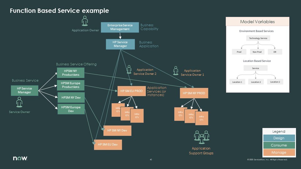

I see your point. We have almost the same situation, and have looked at some examples from the CSDM 2.0 primer for inspiration (I haven't found these to be outdated):
In the above scenario there's a common business service covering all offerings. But in our case, I guess like in yours, there are multiple departments placed in various countries with their own cost centers involved. So we have ended up a bit more like this (using Service portfolio with taxonomy nodes):

To address the support and SLA regime we will add Service Models, so that the support on HP PROD NY and HP PROD Europe in this case would be referencing the "Gold" or "Platinum" Service Model, whereas the non-prod instances would be referencing the "Bronze" Service Model.
The need to roll up information can then be done in different perspectives:
1:From the Business services you can see all offerings that are governed by the same part of the organization (filtered on IT Department)
2: By using Service Portfolios with taxonomy nodes you can also map together services and offerings across your company/group that have the same purpose.
3: From the Technical services you see who's in charge of the Infrastructure and Platform offerings supporting your instances, and if you use the service models you can even see if these are compatible with the service model on the application instances.
4: From the Business application you see down on all CI's that makes up the architecture of the application, and how many instances there are. If you add the software models you can also see what versions the various instances are on.
So we have managed to avoid parent-child relationships on service offerings. We have to invite stakeholders to look into the relationship view to explain things, and it takes a lot of time coaching service owners on how to navigate these, but I think it's worth it.
