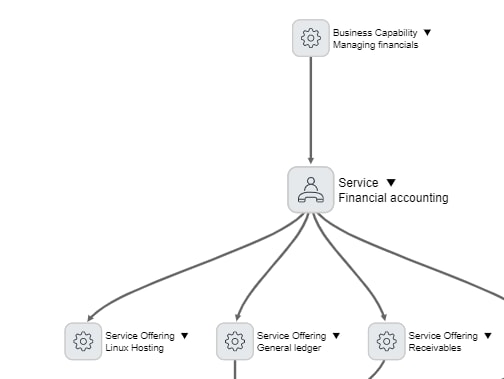

@CasperJT I note in a response above you mention the use of the 'Map related items' feature and the diagram you showed seemed to work.
I have tried this out and it sort of works in that if you look at the dependency map from the service then it shows the service offerings:
However if I start the dependency view from the service offering it does not work upstream to the Servicefind_real_file.png
To me this makes it not very useful as you want to be able to see upstream to understand the impacts within a Service of indeed the portfolio.

Hi Alec,
Just checked this myself and it would appear this is the way it works (currently on New York Patch 7a).
