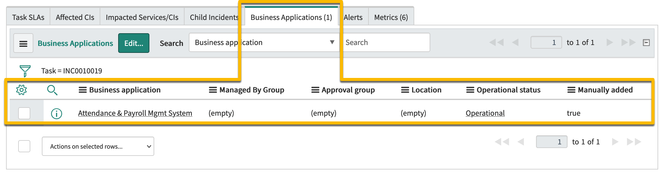

You need to add the corresponding related list to the incident/change/etc form to see it:
