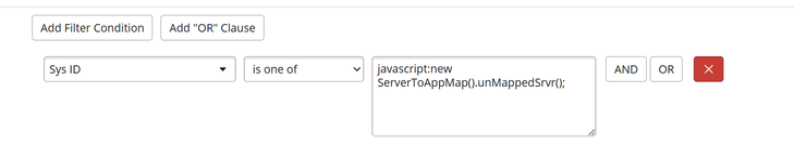

2. Servers that are in scope mapped to a application , (used sysId is one of and called a Script include) - 559 seems realistic
3. Servers that are in Scope and not mapped to a application (used sysId is one of and called a Script include) -Number is more than servers that are in Scope

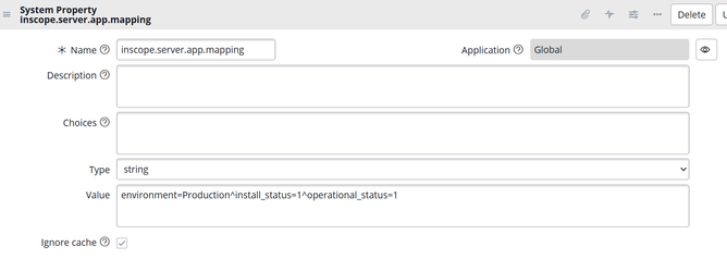

        var inScopeQuery = gs.getProperty('inscope.server.app.mapping');// Used same property for Mapped servers too
        var grSer2 = new GlideRecord('cmdb_ci_server');
        //grSer2.addEncodedQuery(inScopeQuery ); //Seems like this failing , return count shows more thanCIs as per below scope , returns 9000~
        grSer2.addEncodedQuery('install_status=1^environment=Production^operational_status=1'); //This is same filter as property, count is within scope, returns 751

Ankur Bawiskar
@pardhiv
-> gs.getProperty() won't work in client callable script include when it's called from a reporting filter condition as it will be executed on client side.
I have faced similar challenge earlier and was surprised to know this drawback.
Instead you can query sys_properties table with that property name and get the value and then use
I shared solution for this in 2022
Client Callable Script include issue as script filter in reports
Before: I am using gs.getProperty() and it didn't give result
After: I used GlideRecord to query properties and used and it worked
gs getProperty in script include report filter condition working with gliderecord.gif
