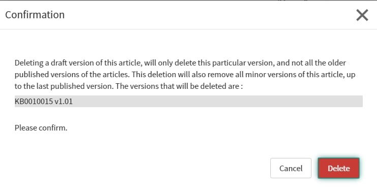

The modification can be abandoned by deleting the current draft version. It deletes all the versions created after the last published version. Please find the below snipped of the confirmation while deleting the checked out draft version of KB article.

Thanks Alok, it appears the [Delete] function was hidden on our instance by our systems integrator and replaced by a [Cancel] function.  Since the [Cancel] function doesn't remove the unpublished revision or restore the 'latest' = true on the previously published version, the user has no way forward.
I did test deletion from a list view of all articles and it appears to work the same way as you describe.  Therefore, I will advocate for restoring the out-of-the-box functionality and as a workaround, perform deletions upon request from list view.
