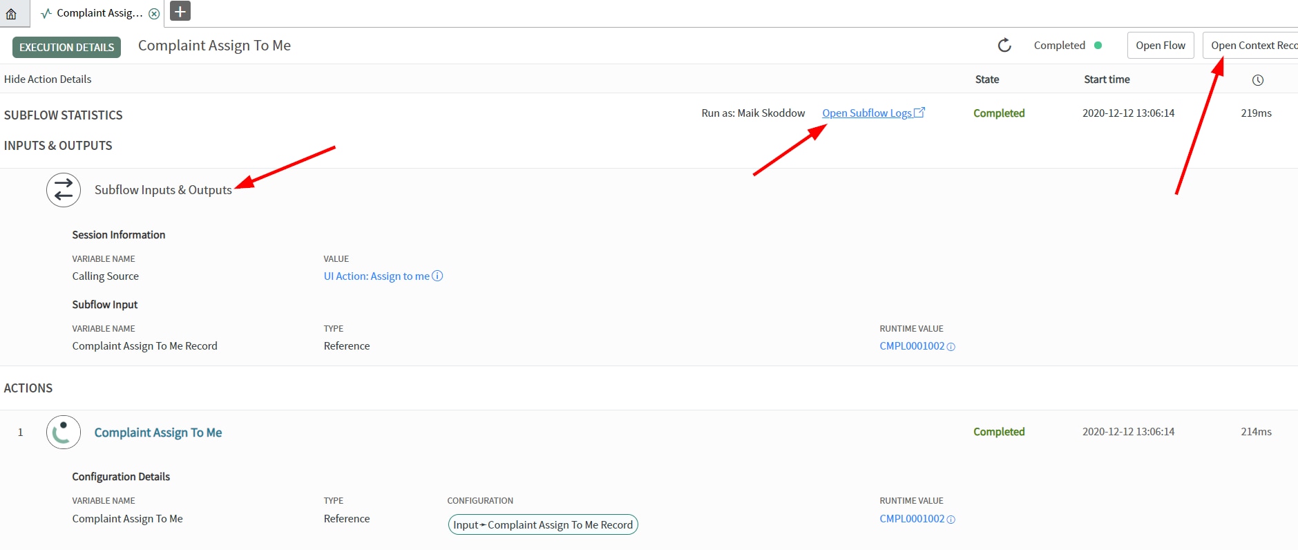

Hi @Ziad Qadora ,
in Flow Designer go to tab "Executions"
Open a single item. In the following dialog you have different options to make output, log statements and variable values visible:
Kind regards
Maik
