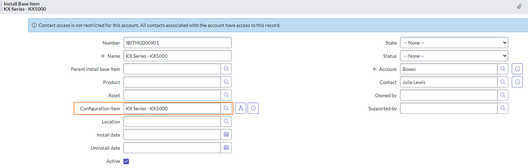

If i take the streaming service example, for the "streaming device" install base item, i supposed i would be able to link the install base item to a hardware configuration item.
Example:

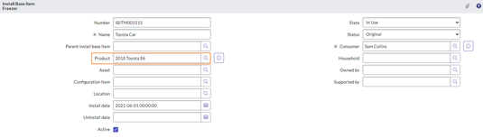

But if we are talking about a car as an install base item, as i'm not sure which cmdb_ci class i can store the car in, would i be able to choose any configuration item to link the install base item to? So i wonder, if in this case I would just need to choose the product model (from the Product field) in the install base item record.
Example:

Hi @Flavia Margaret ,
Your assumption about the "streaming device" Install Base Item and a link to a respective hardware Configuration Item is absolutely correct. You clearly understand the concept and how CSM now can work together with ITSM, connecting the different support sides on the service provider side.
The reason why I repeat this is because of the car and a potentially related Configuration Item. Imagine being the car manufacturer, hence the service provider, and you track the cars as Install Base Items (which is good practice). Then the next questions would be: do we need to track individual Configuration Items for each of the "car" Install Base Items? And if so, which Configuration Item class should we use?
- Must we track a Configuration Item for a car? If the car runs on digital technology (for example: firmware, CPU, GPS, ...) you support as a service provider: yes. Otherwise, no Configuration Item is needed.
- Which Configuration Item class should we use? If the answer to the previous question is "yes"; use the Configuration Item class that fits the attributes that must be tracked for the cars best. This is where database design comes into the picture as you must determine, based on existing table attributes and table inheritance, which table is the most suitable. This is a separate exercise, but I would not use the root cmdb_ci as most likely you would create custom attributes (= fields) unique to the cars, and you want to avoid clutter as all CI child tables of cmdb_ci will inherit those new, custom attributes. So definitely somewhere "lower" in the CMDB class tree.
If you ask me, tracking the "Product" on an Install Base Item is always a good practice regardless of whether a Configuration Item is tracked for the Install Base Item or not, especially now ServiceNow has a Sales and Order Management solution that appends CSM and relies on Product "core" data.
