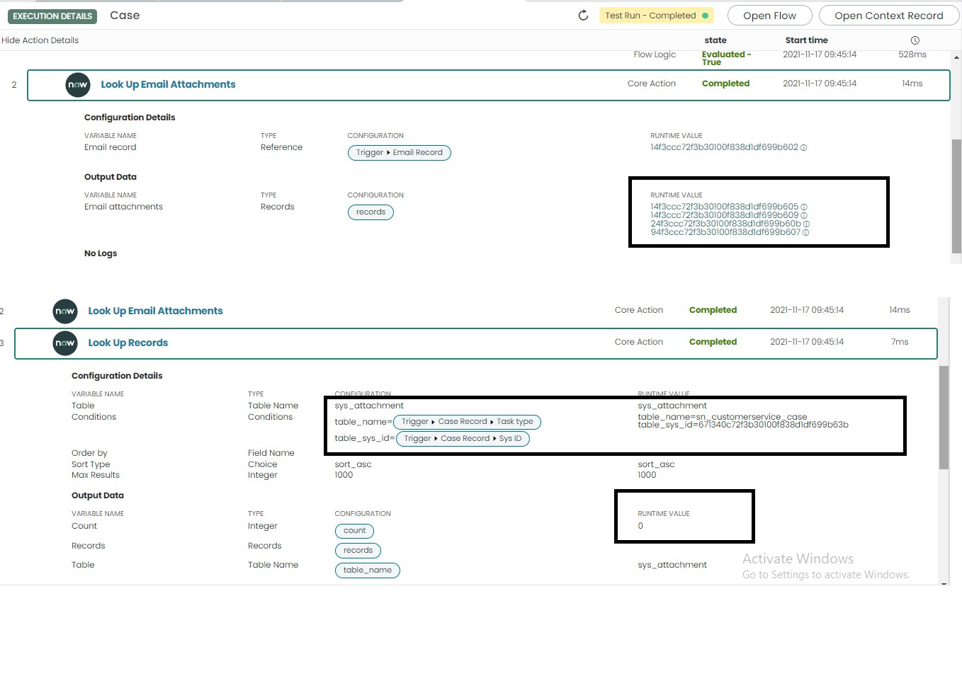

How to check replied email has attachments Or Not in Flow designer.

Yes Ankur,
even i tried to map with "Look up Email Attachments" to "Look up records"
really it become hard to get Count here.
I believe there is a fault in the filter:
Hi Janos,
Thanks for Reply,
Please help me what is the filter condition i need to setup in INBOUND action using with  CSM Case Table.
Is it Correct please? , but still returning 0, but it has 4-attachments in Email logs(sys_email) table record.
what showing count still "0",
how to push attachments Email log-----> Target record (case table record).
Actually what I said earlier is not correct. The correct filter is:
