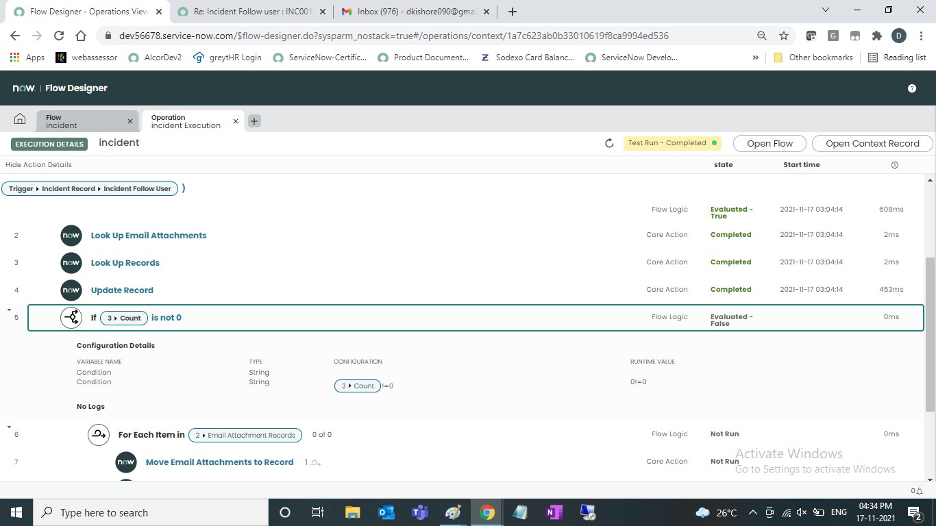

kindly check my side screenshot. i can see only this one .
what i do now. please advise

Please check the condition is correct
yes now use Count from this Look Up Attachment Records
Hi Ankur,
kindly see resultant output, suggest me please
